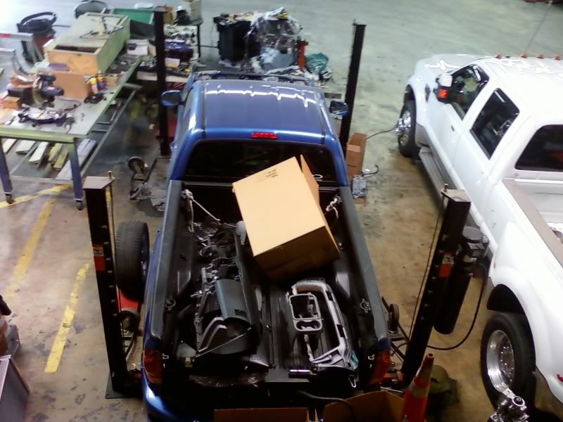

ok so as you all know rexrunner is doing an ls1 swap in his truck. i believe he sold his turbo kit already. we got his injectors flow benched and as we expected his injector in cylinder #6 was clogged. the whole time during the dyno and everything. thats why he was on an a/f of 10.8 when he dyno'd to compensate for the clogged injector IMO.. at 7psi it made just under 500 hp and 600trq it was legitly fast for anyone who questions his kit or his truck. i can vouch..anyways heres the pics

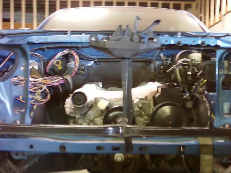

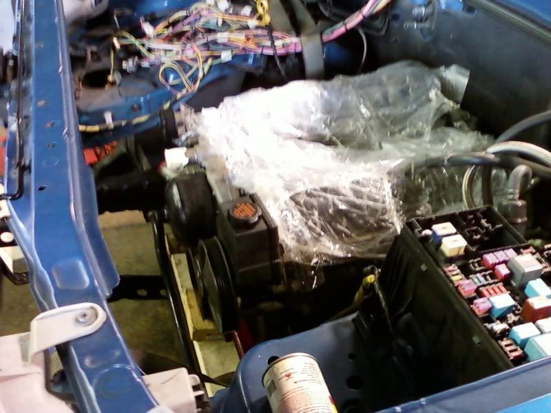

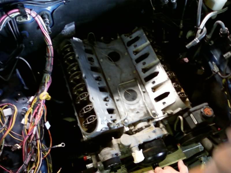

hehe ls1 comp. in stock location :bird:

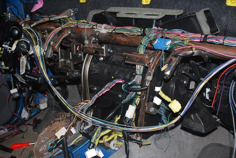

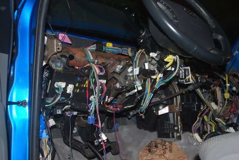

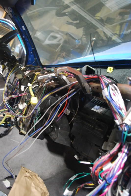

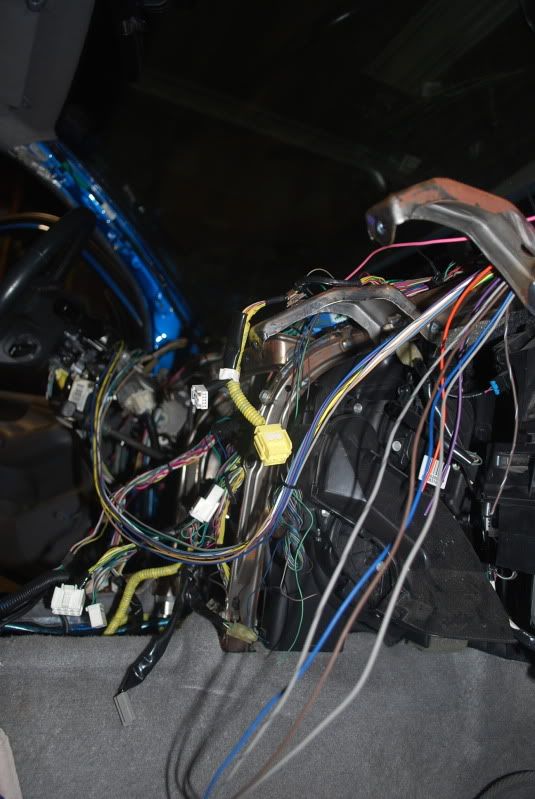

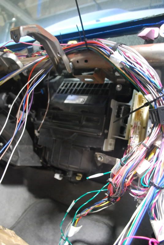

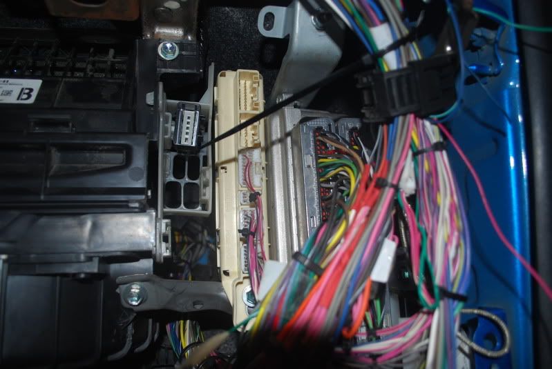

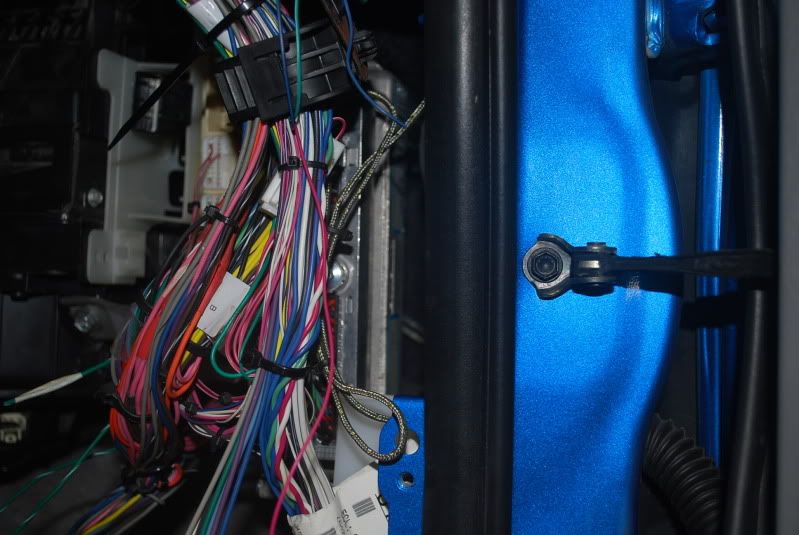

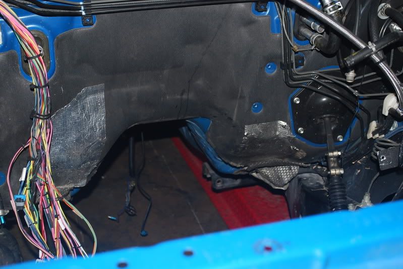

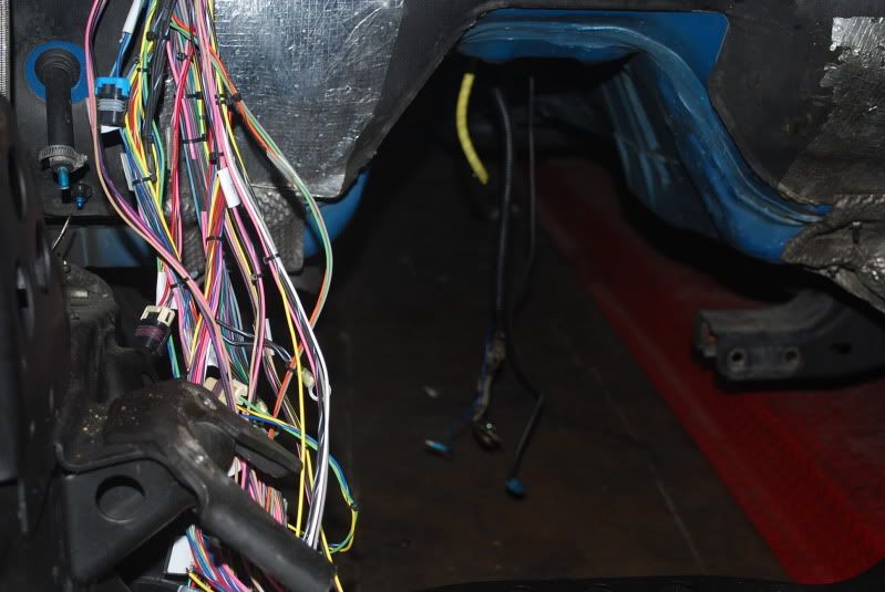

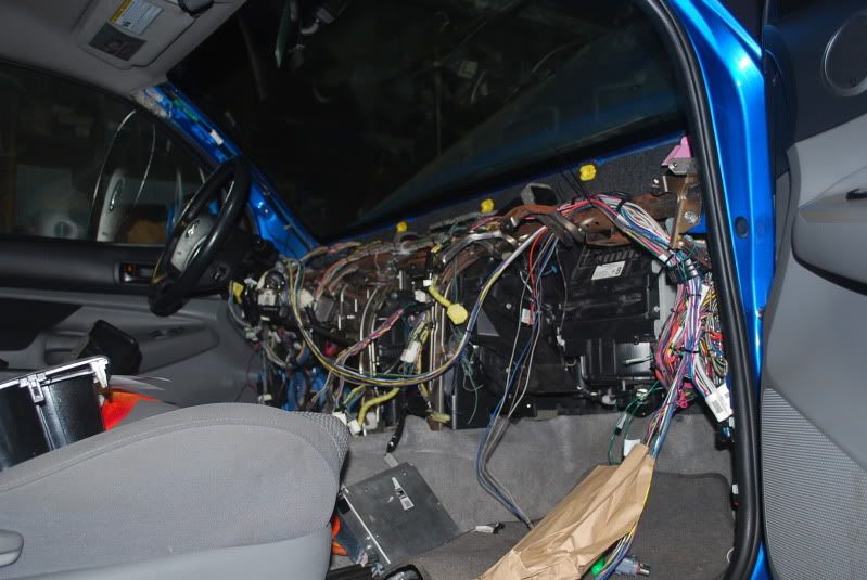

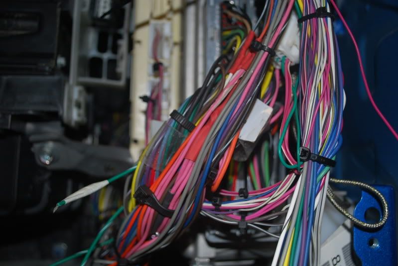

all the wiring is done in the truck we ran the painless harness. keeping cruise control and obd2 :rock:
pics were taken a few weeks ago. progress has kept up

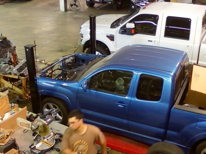

update, so he decided to cut the factory mounts that are welded to the frame, to make a good base for a 3/8" steel plate as support. motor is sitting in the engine bay on blocks until monday when his tranny mount comes in.
