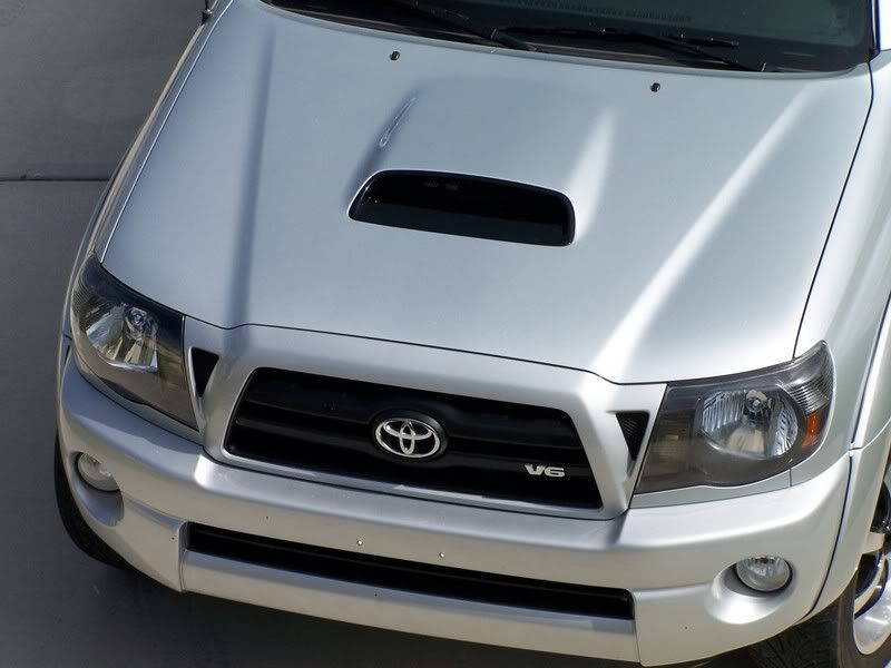

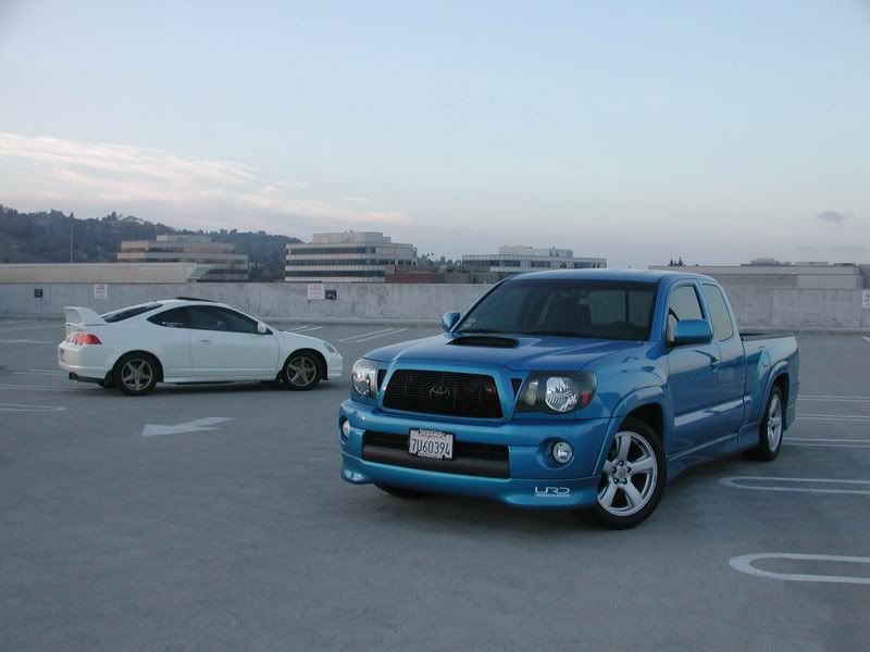

Well basically you open the hood, and there are 6 screws. 5 bigs ones and 1 small one, unscrew them, make sure they dont fall down the support framing, and take off the hood scoop front lower piece. Sand it a bit, and paint that sucker. I cleared mine, looks better, trust me. With the black headlight mod and a black grille, it looks pretty nice. It's not over bearing because most people dont even notice it at first. In fact mine has been black for 4 months and just the other day my friend noticed it and complimented it. Here's a nice pic of one and then one of mine.
What kind of paint did you use?

hmm i sanded it down, then i used 3 coats of gloss black krylon fusion and then 2 coats of clear. :top:
