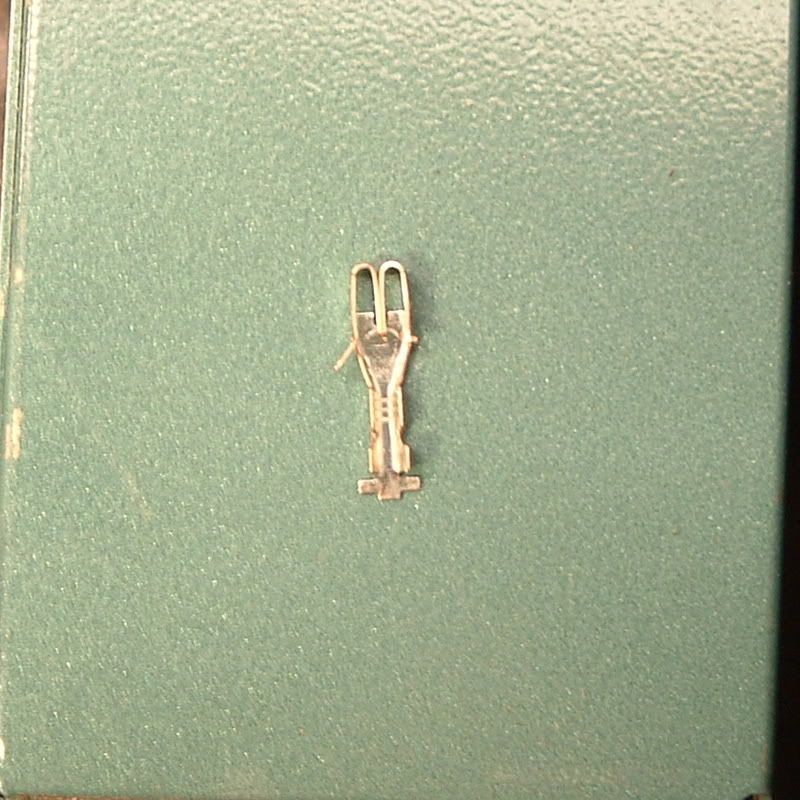

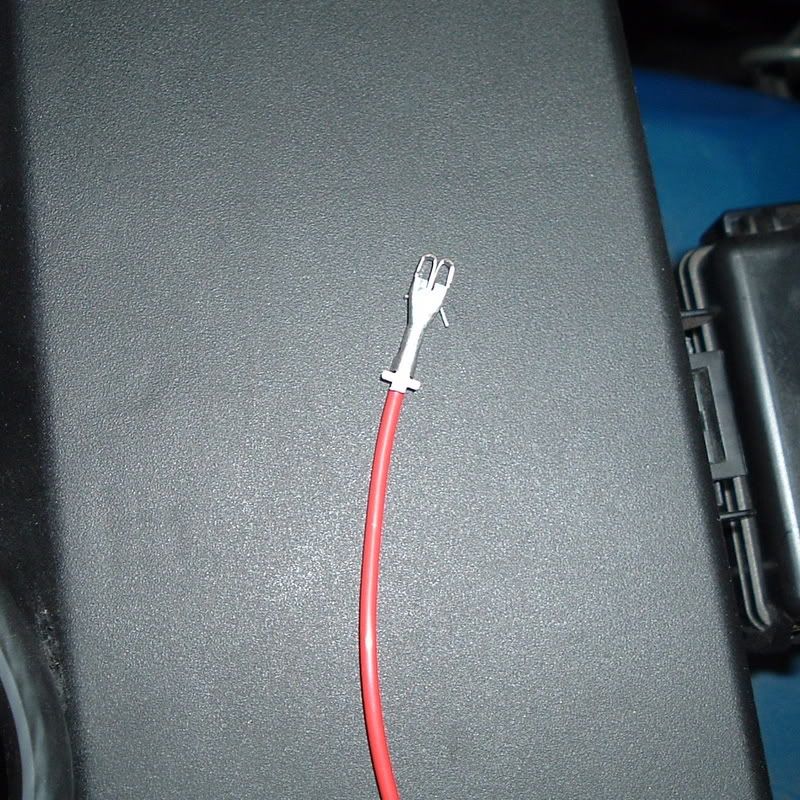

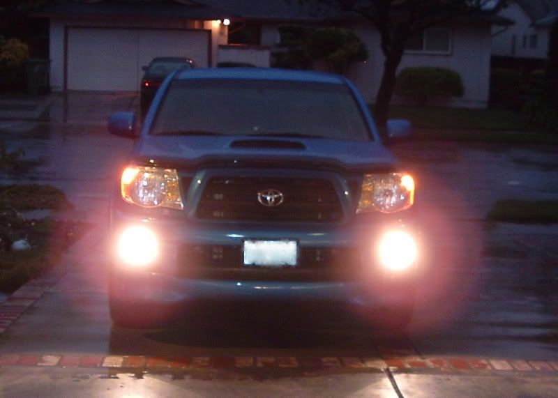

I did option 1 but instead of splicing the green and red/black wire together I hooked the red/black wire ( relay coil side ) into its own 10 amp fuse that I added using a spare from the fuse block. So the fog lamp relay switch has its own 10 amp circuit.
spare fuse socket
add terminal to spare socket
added fuse
finished product
