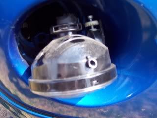

ok its so simple its scary the two little plastic things i have circled is all that holds the fog light in the bumper all you have to do is reach up in there and press them while carefully pushing the light out ...took all of a min. to do :top:
NICE... thanks for the help and pics...:top: If i ever get a day off of work ill get on that cause its driving me nuts havin water in them... Looks like S***!:thumpdown:
no problem ! believe me its really simple you will take more time taking the bulb out then poping the assembly out :top:
