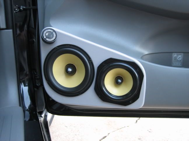

Save yourself $30 and make them yourself out of MDF. I made these myself for less than $10. Not the best but will do untill I learn how to glass. You'll need Dynamat the crap out of these doors too.:biggrin:
How did you mount the mdf to the door panel?
Looks great BTW...

Initially when I bout the XR, I purchased their DD dash kit and the 6.5 frint adapters(I had some 6.5 separates and a DD head unit from my previous truck). TacoTunes delivered within a few days, no problem. Later I purchased some rear 6.5 speakers and prior to obtaining the Xtreme Kreations door-sub panels, I made my own MDF adapters (for under the door panel, stock location). All you need is to measure the stock speaker base and place your new speaker template centered in the new blank you made. Then use a jigsaw/router or dremel to cut and shape it. It does not have to be pretty, it's hidden. You cabn usually buy the MDF in a half or quarter sheet for around $4-6. Depending on the height of your speaker, try and get it close to the door panel. I ended up using 1/2".
