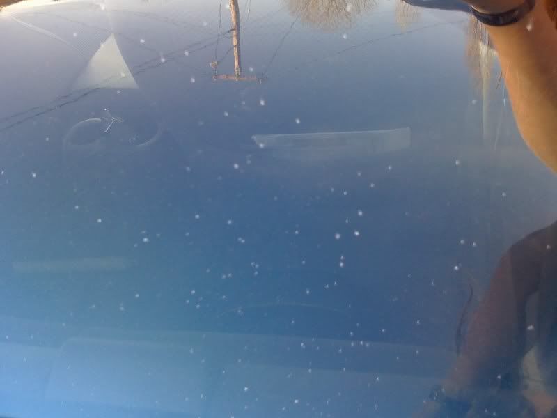

ok this is the best pic I could get, it's pass side.
I haven't read the whole post but I would say it looks like welding splatter. Could of happened from a grinder throwing sparks as well. I would assume they had your bed off while fabbing up your air setup and could have caused this.:dontknow:
Ouch! That's pretty rough looking Lenie. :frown:
but wouldn't it of messed up the paint too. From what I can tell there's nothing wrong with anything else.
I would bet if you took the bed off you would be able to see something wrong with the paint on the backside of the cab. The bed lid sits higher than the window seal so it would hide any damage to the paint on the rear of the cab. If they were grinding on the frame and throwing sparks upward towards the window it wouldn't hurt the top of the truck. Notice how in the pic there seems to be more of these pits towards the bottom of the window and thins out as you go up.
