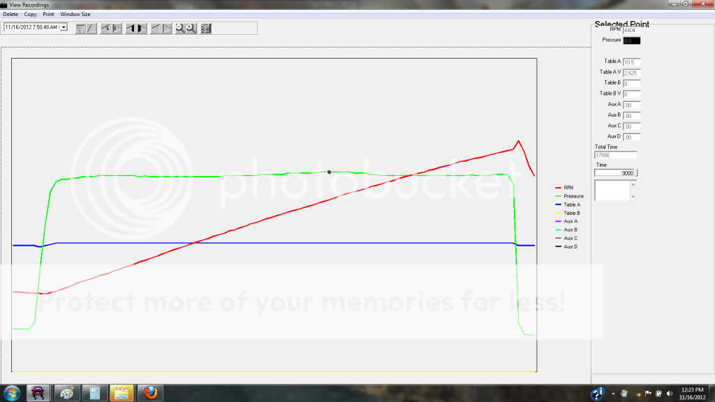

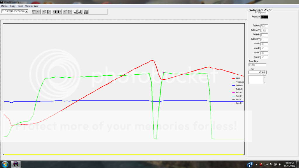

of course, when I go to prove it the truck makes me look stupid, 7.5 lbs was tonight's high, but it's about 10 degrees warmer than when I tuned it. I know it was at 9 lbs, because in my tune I added fuel to the three cells where it was at 9lbs halfway through the pull. I will keep trying until it does it again.

When using the table, the active cell will jump to the next higher pressure cell. Generally it is .5 PSI higher than actual. So as you exceed 7 PSI it will move to the 7.5 PSI cell.
I can select REAL TIME and open the pressure gauge and get a better reading of the true manifold pressure. You can expand it out to take up the full screen so you can see it real well.
G

The real time is what's in the picture. I didn't get a recording of the 9psi run or i would put it up.
