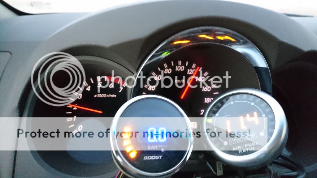

A couple months ago I had done very precise fine-tuning on closed-loop operation, to get it just right. After I felt very satisfied, and got most closed-loop AFR above 12:1 AFR, I went on a road-trip. While going on the trip this is what showed up in my AFR gauge:

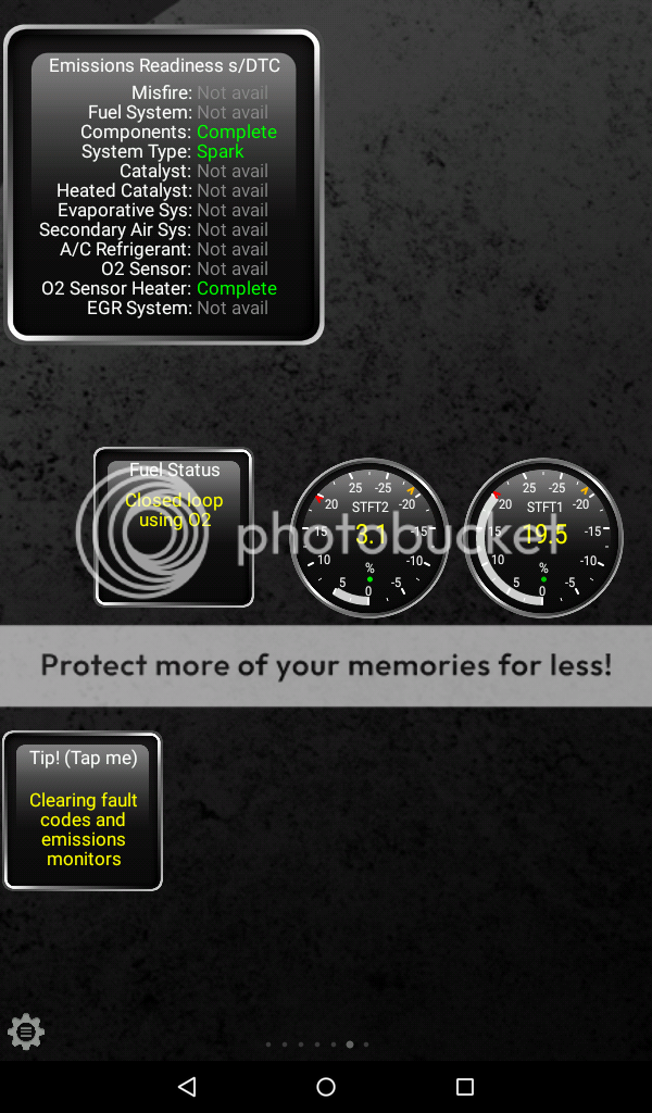

I was shocked, why is it getting so rich? I just finished getting closed loop done properly? So I thought there must be something wrong. I pulled out my OBDII scanner, started up my tablet, and got connected to my ECU, to find this:
My right bank sensor was giving a wrong reading, and the right bank fuel trims are going haywire. Left bank is doing ok. So I knew this is either a bad AFR calibrator, a bad AFR sensor, or a bad harness. This problem only appears after driving for a while in the hot weather. Doesn't appear in the winter.

I think you misunderstood. I had a faulty sensor, which kept flooding my right bank cylinders when it got hot. The problem was solved when I replaced it.
