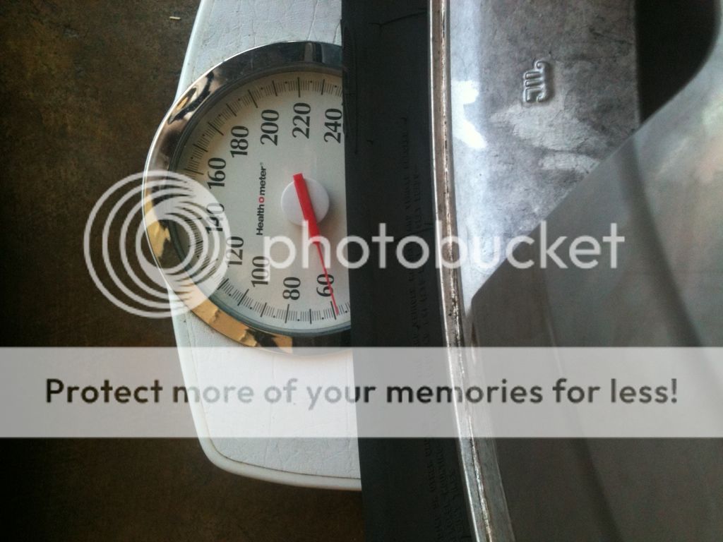

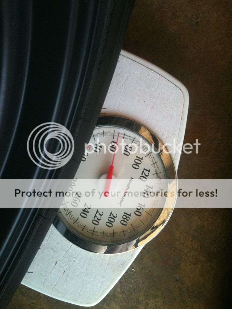

This is just more info for my lastest dyno. I did it on Torspd's wheels and tires.
[ame]http://www.youtube.com/watch?v=MQSOcUrxZ0I&list=UUjRB7F3jkrbSZErjtXaRa2g&index=2&feature=plcp[/ame]
And I was curious how much they weighed compared to my wheels.
Well here are the results.
My wheels
Torspd's wheels.
My wheels weigh 59 pounds each and Torspd's come in at 65 each. That's a 6 pound difference for one wheel, 12 pounds for the drive wheels, and 24 pounds added to the total vehicle weight. Obviously this weight would effect the power, granted it is a small amount but still it goes to show the potential power that is to be achieved.

17in vs 20in.
I would think the 20s weigh more. Kuz there.bigger.
Now im really curious to know how much my wheels weigh.....
